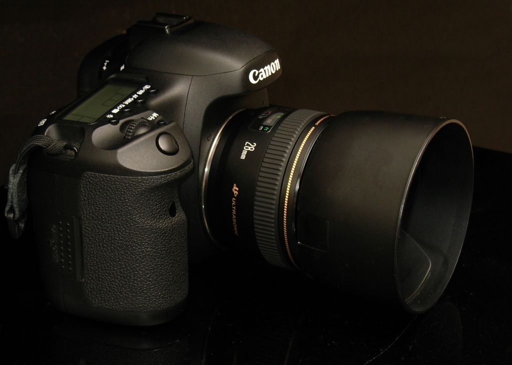

Since I use a crop camera, I use longer hoods whenever I can:
I thought the 28mm 1.8 EW-63 hood looked a little anemic. I had a couple of old 3rd party hoods lying around so I glued an EW-63 inside an ET-65. I had to open up the rear of the ET-65 a little and also remove the "clips" to make it all work. It doesn't vignette on a 1.6 crop body, but it does on a full Frame.
It also can be reversed on the lens for storage.

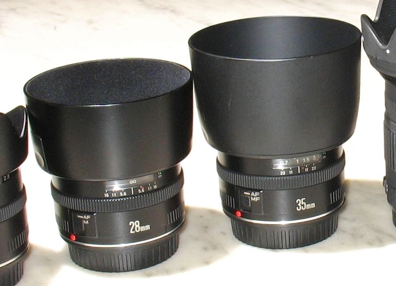

EF 35mm f/2 with non standard ES-65 hood (does not vignette on a crop body)

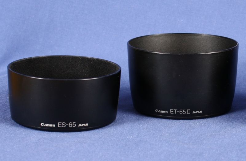

ES-65 on the left... ET-65 on the right.....
