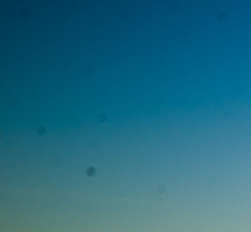

The D600 is working very well for me in Death Valley. But my sensor is already very dirty. I don't change lenses often, and it's not windy here at all. Have no idea how it's gotten this dirty already. The stock sensor cleaning process doesn't help much. Is this just something I have to get used to with full frame?

Have you locked up the mirror and had a direct look at the sensor? Can you tell if it is dust or oil? Some bodies seem to have to much oil on the shutter mechanism that leaks onto the sensor. This problem has been reported on both the D800 and D600.

Couldn't see anything with the naked eye on the sensor. Here's a 100% crop of a sky shot, to give you an idea.
IMAGE: http://img.photobucket.com/albums/v129/soybomb/DSC_0701.jpg
I mean that's just ridiculous. I've had this camera for a week. I've owned 2 Rebels for 3 years a piece and never had to clean the sensor.
Guess I should get a cleaning kit.

^^^ Some type 3 swabs and eclipse fluid works for me. Of course there are different ways of doing it.

Would canned air be safe to use? Might be able to find a computer store or a Wal-mart today on the way to the Eastern Sierras.

No, I wouldn't use that. Find a camera store and buy a rocket blower. Start with it, if it doesn't work move up to one of the swabs and wet cleaning

There's a dust removal feature in-camera. You take a picture of a white piece of paper 10cm away and it stores the info. Gonna try that for now. I'm nowhere near a camera shop. :(
